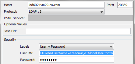

Log into the LDAP browser using the following fields on the login screen:
The host name of the Provisioning Server.
20389
Username + password
eTGlobalUserName=etaadmin,eTGlobalUserContainerName=Global Users,eTNamespaceName=CommonObjects,dc=im,dc=eta
The password used for the _impd_etaadmin_pwd in the Provisioning Server installation.
