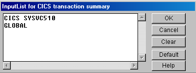

CA GMI uses the input list to pass parameters to CA SYSVIEW objects.
Follow these steps:
The Input List dialog opens.
The input list data for CA SYSVIEW objects uses a keyword-parameter pair format:
KEYWORD parameters

Examples: Passing CTRANS parameters
The following examples show switching modes and address spaces in the CICS Transaction Summary display.
CTRANS Local PARM Local Local
CTRANS Global PARM Global Global

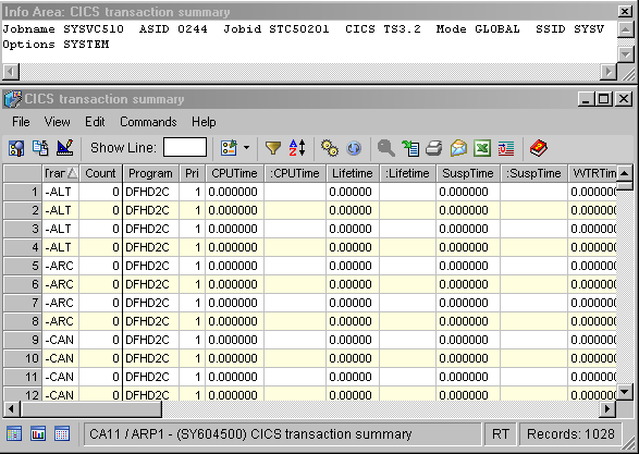

After the object executes, the CICS transaction summary data displays for the CICS SYSVC510 region and GLOBAL mode.
For the address space switchable objects, the Info Area usually contains the name of the address space in focus.
