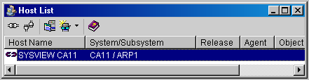

The Host List dialog opens. The following is a sample of the Host List dialog.
If your user ID and password were provided in the Host Definition dialog for the selected host, the GMI Windows Client attempts to connect to the host. If the connection is successful then the connection status icon changes from the Not Connected icon
to the Connected icon
. You can skip to step 4.

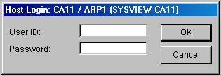

If your user ID and password were not provided in the Host Definition dialog for the selected host, then the Host Login dialog appears as shown in the following sample. You must proceed to step 4.
Enter a valid user ID and password in the Host Login dialog, and click OK.
The Host Login dialog disappears.
