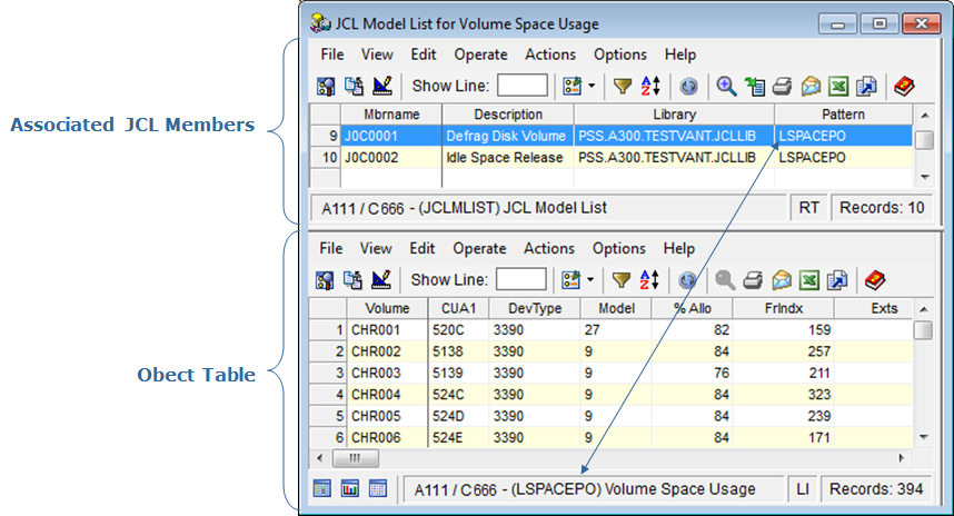

The JCL Model List dialog appears. The JCL Model List dialog displays the object data and the list of JCL members associated with that object in separate panes as shown in the following sample:
The Object Table pane displays the object selected. You can use the object view menu options in the pane to change the object view, such as sort, filter, zoom, and so on.
The Associated JCL Members pane displays the JCL models you have created and linked to the object selected. You can use the Associated JCL Members Action options to modify the JCL Model information displayed in the pane, add new JCL models, and to delete JCL Models.
Note: For more information about the Associated JCL Members pane, click the menu bar Help option and select Help About Object.

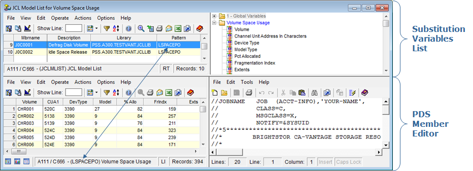

The following sample shows how the JCL Model List displays all 4 panes in the JCL Model List dialog.
Using the PDS Member Editor pane you can edit the model JCL, create new JCL Models, insert variables, substitute variables with object information, submit the JCL, and so on.
Note: For more information about PDS Member Editor options click the Help option on the PDS Member Editor pane Menu Bar.
The variable appears in the PDS Member Editor pane where you indicated.
Now you are ready to substitute the variables in your JCL with object line information.
When you do this, a new PDS Member Editor dialog is opened with the resulting JCL; that is, the field values from your selected object table lines are substituted into the variable locations in a copy of your JCL model in a new PDS Member Editor dialog.
