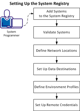

You perform the following tasks to set up the system registry in CA CSM:
This illustration shows each of the steps the System Administrator needs to perform to set up the system registry in CA MSM.
  1. Add systems to the system registry.
  2. Validate systems.
  3. Define network locations.
  4. Set up data destinations.
  5. Define environment profiles.
  6. Set up remote credentials.
Add and then validate each nonstaging system in the enterprise that you are deploying to, to the CA CSM system registry. You can only send a deployment to a validated system.
This process applies to each nonstaging system in your enterprise. For example, if you have five systems at your enterprise, then perform this process five times.
Note: After a system is validated, there is no need to validate it again. However, you can revalidate a system any time.
