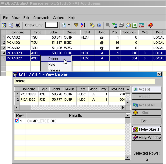

- The following example shows using line actions to delete lines in the object.

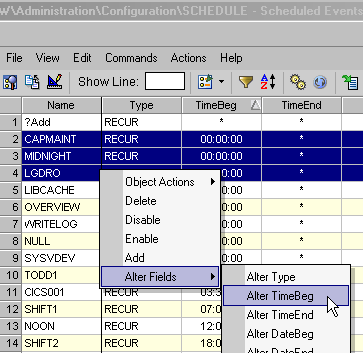

- The following example shows the Alter Fields drop-down menu selections. These selections let you select a field and change its value, like Alter TimeBeg to change the begin time, for the selected row or rows.
