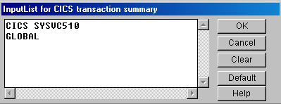

Examples: Passing CTRANS parameters
The following examples show switching modes and address spaces in the CICS Transaction Summary display.
For the address space switchable objects, the Info Area usually contains the name of the address space in focus.
