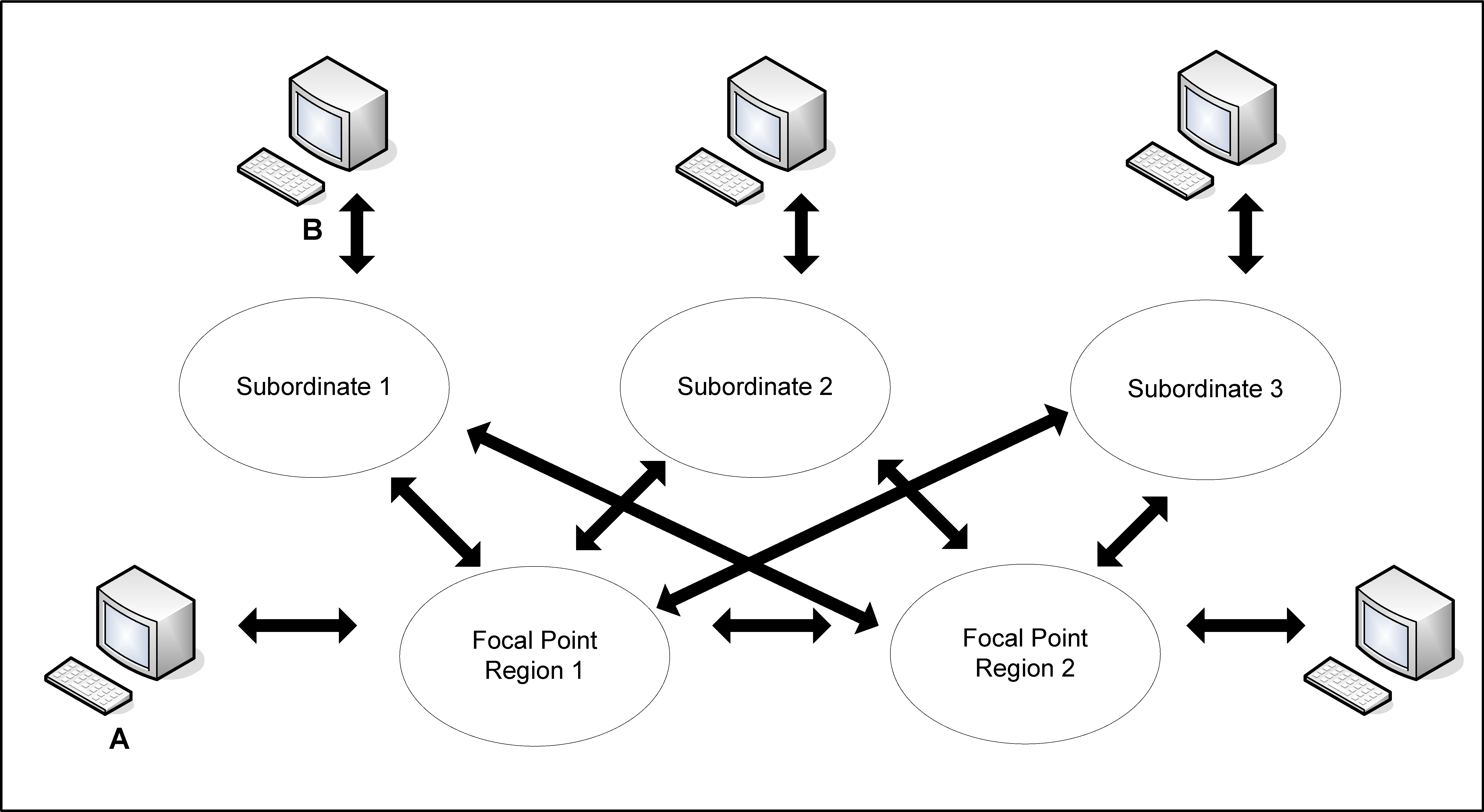

If you have multiple systems, deploy CA NetMaster NM for SNA in a multisystem environment to provide a consolidated view of your enterprise.
The following diagram shows an example of a multisystem environment. Logging on to Console A allows visibility to all resources. Logging on to Console B allows visibility to the subordinate system image only.
The diagram shows a multisystem environment where Console A has a consolidated view of the systems.
