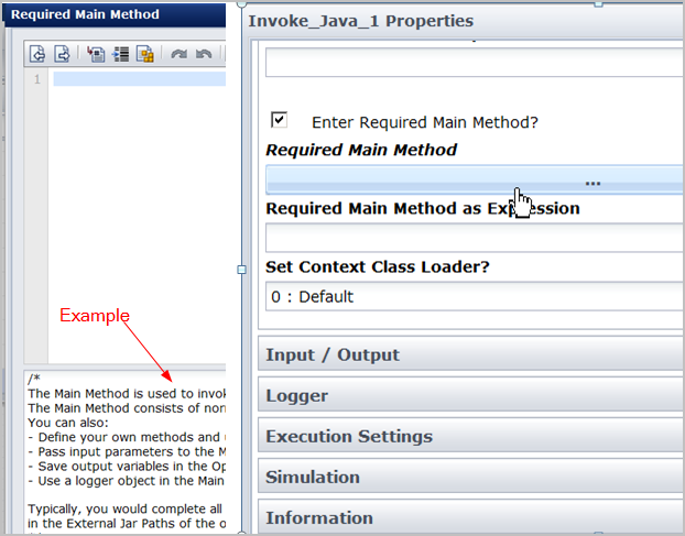

A new example panel has been added inside the Required Main Method text area of the Invoke Java operator. You can display or hide the example with a click of the Hide Examples button. The MyAccount.jar file is required to run the provided java example. The installation or upgrade process adds the MyAccount.jar file to User Resources (located in the invoke_java_op_example_jars folder) in the Domain Orchestrator. CA Process Automation then mirrors the MyAccount.jar file throughout the other nodes in your system. See "Resource for Running Invoke Java Operator Example" in the Content Administrator Guide.
