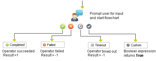

The Assign User Task operator has four standard (noncustomized) exit links:
Processed when a user does the following things:
The parameter values are assigned to operator dataset variables. The Result variable is set to “1” and the Reason variable is set to “COMPLETED.” The task displays in the Task List on the Operations tab with a state of "Completed."
Processed when:
The Result variable is set to "-1" and the Reason variable is set to CANCELED. In each case, the task displays in the Task List on the Operations tab with a state of "Canceled."
Processed if the user does not complete the interaction request form within an optionally specified time-out interval. Any parameter values are assigned to operator dataset variables. The Result variable is set to “-1” and the Reason variable is set to “TIMEOUT.” The task displays in the Task List on the Operations tab with a state of "Timeout."
Processed if the user selects Reject at the user prompt (in the Form Disposition field). The Result variable is set to “_” and the Reason variable is set to “REJECTED.” The task displays in the Task List on the Operations tab with a state of "Rejected."
