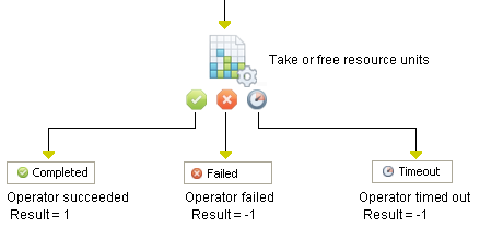

The Manage Resources operator has three possible exit links:

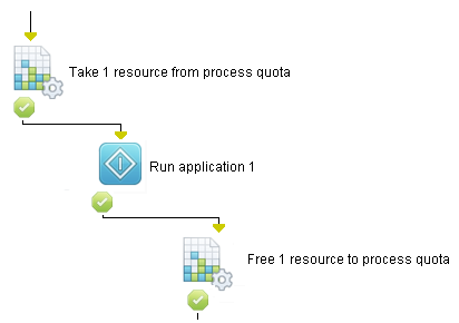

Resources are typically taken from a resource quota before processing other operators and then replaced when the operators are completed:
