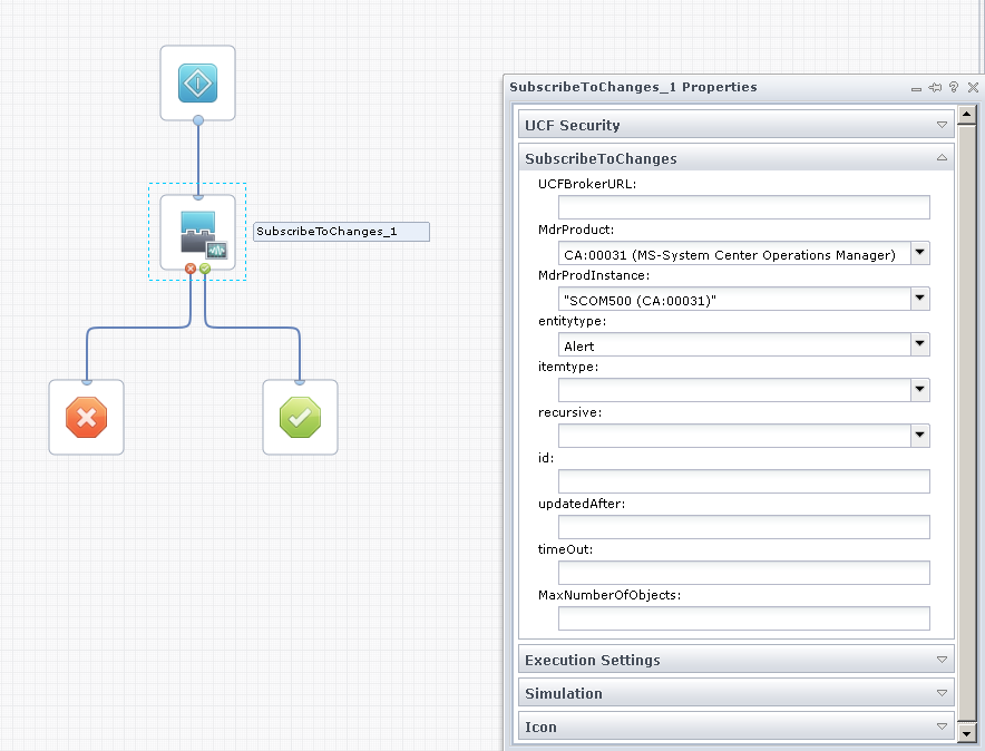

- Add the SubscribeToChanges operator to a process.
- Select the SCOM Connector from the MdrProduct/MdrProdInstance lists and Alert from the entitytype list.

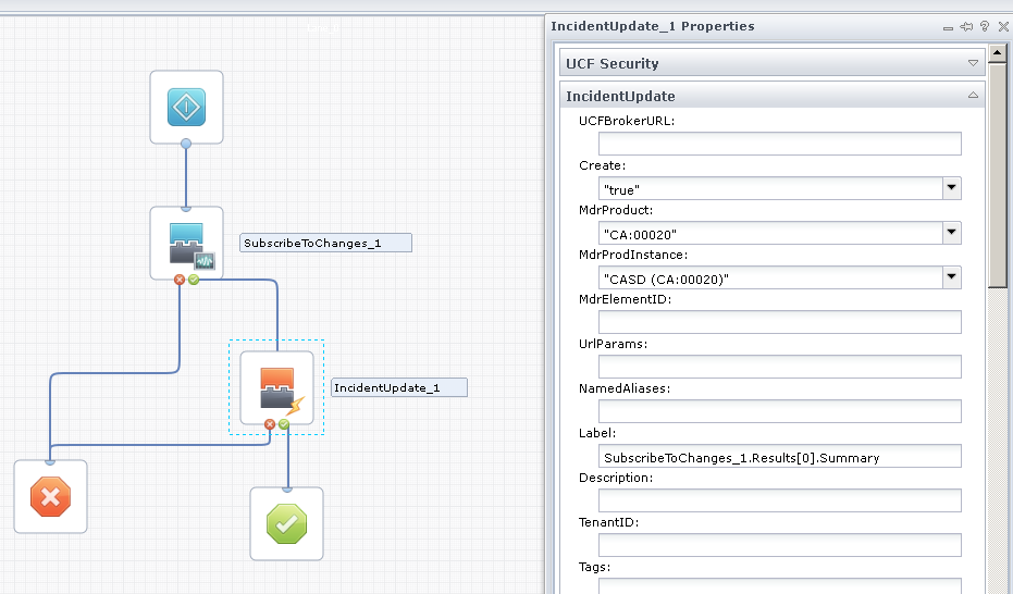

- Add the IncidentUpdate operator to the process. Select the Create check box and the Service Desk Connector from the list.
- Set the values of the Incident properties using the properties of the SCOM Alert object as variable expressions.
