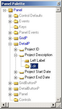

  2. If it is not already expanded, expand Panel to display the regions on the Edit panel.
  3. Expand the DetailP region, and then expand the Project Description field.
    Defining a Multi-line Edit Control
  4. Select the Edit control.
    The values in the Property Sheet indicate the properties you can change for the edit box. Also, notice in the Design Window that only the edit box next to the label Project Description is selected.

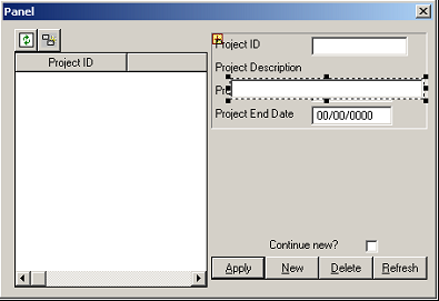

  5. In the Design Window, drag the edit control below the label, so that its left edge lines up more or less with the j in the word Project. Do not be concerned that it covers up the Project Start Date field—this is fixed later.
    In the Property Sheet, the Position (Col, Row) property changes as you move the element. If you want to make fine tuning changes, you can specify the exact pixel location in the Property Sheet.
    The field still extends past the right edge of the panel.
  6. In the Property Sheet, click the Size (Col, Row) property.
  7. In the edit area at the top of the Property Sheet, change the value to 200, 20, and then click the check mark button.
    Defining a Multi-line Edit Control (1)
    The edit control resizes so that it fits within the panel, and the beveled box that surrounds the fields resizes so that it is just slightly wider than the fields.

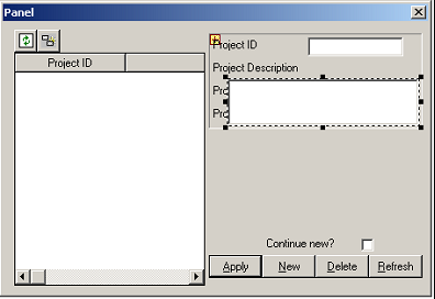

  8. Now, drag the handle on the bottom center of the edit box to make the box taller. Make it about three times as tall.
    The panel should look something like this:
    Defining a Multi-line Edit Control (4)

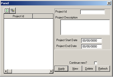

    In the Design Window, you can see that the beveled box around the fields resizes to fit around all of the fields:
    Defining a Multi-line Edit Control (6)
