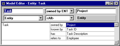

  2. Drag the Task entity from the Object Browser to the body of the Model Editor. The Model Editor should look like this:
    PLEX--Defining the Task Entity (2)
    These are the triples that CA Plex added to your model when you created the diagram in the preceding lesson.
