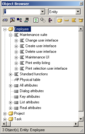

  4. Refresh the Object Browser, and then expand the Employee entity until the Object Browser looks similar to the following example.
    PLEX--Defining the Employee Entity (2)
    Notice that Employee inherited the function Maintenance Suite, which has the functions Change User Interface, Create User Interface, Delete User Interface, and Maintenance UI scoped to it, each of which scopes a panel object. These four functions display panels on which end users can add, change, and delete Employee data. You will see how the functions interact when you generate and build the Employee entity at the end of this chapter. (You will not use the two print functions in this tutorial.)
