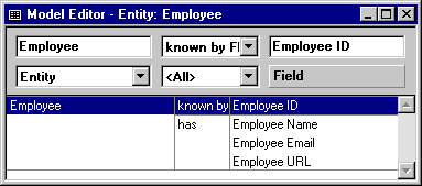

  6. For the Employee entity, repeat Steps 1 and 2 to define a primary key called Employee ID, and Steps 4 and 5 to define the following non-key attributes:
  7. Select the Employee and Task nodes and use Auto Layout. Make sure that each entity is in a corner of the Diagrammer window.
    PLEX--Defining Attributes with the Diagrammer (1)
  8. Open the Model Editor.
    Note: If it is already open, click the Clear Focus toolbar button:
    Defining entities and their attributes in the Diagrammer created corresponding triples in the model. In the next section, you define relationships between the entities (which also creates triples).
