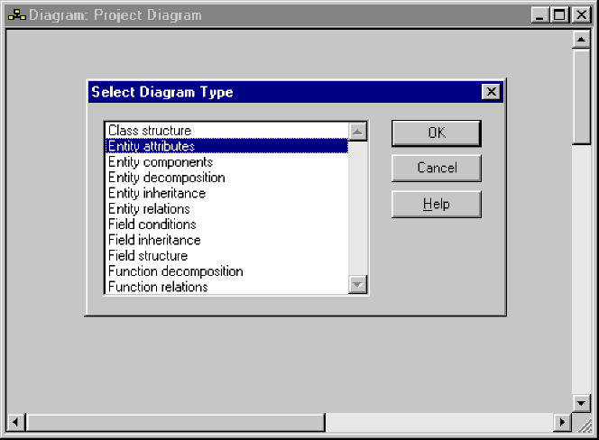

  3. In the Object Browser, select Diagram from the object type list.
  4. Select Project Diagram from the list, and click the Editor button on the Object Browser.
    The diagram opens with the Select Diagram Type dialog on top:
    PLEX--Creating a Diagram (2)
  5. Select Entity Attributes and click OK.
    You can now work in the diagram you just created. A diagram is like a canvas, on which you put nodes, sub-nodes, and links between nodes, to represent your data model.

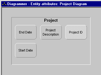

  8. From the Layout menu, choose Always Show Sub-Nodes.
    PLEX--Creating a Diagram (8)
  9. Click the Refresh button.
    The diagram now displays the attributes you defined for the Project entity in the chapter “Defining Entities.”
    PLEX--Creating a Diagram (6)
    Notice that the node automatically resized to show all of its attributes.
    The Project ID sub‑node has a lighter color to indicate that it is a key. You will see later in this chapter how the Diagrammer uses display characteristics to indicate foreign keys and other special attributes.
