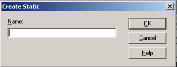

  1. In the Panel Palette, right-click Selector text, and choose Create Static from the pop-up menu. The Create Static dialog appears:
    PLEX--Adding Static Text
  2. Enter 5=Work with tasks in the Name field. Then click OK.

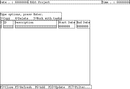

  4. Notice that, in the Design Window, the selected static text is behind the text at the top of the region. Drag the static text down and to the right so that it is to the right of 4=Delete.
  5. Your panel should look something like this:
    PLEX--Adding Static Text (2)
  6. Close the panel design and save your changes.
