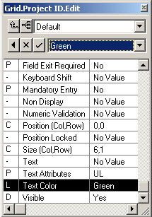

The Property Sheet shows you the properties of the elements that you select in either the Design Window or the Panel Palette, and enables you to change the settings for those properties. Among other things, you can change color, (in some cases) size, and position. To see what you can change about an element, select it in the Design Window or the Panel Palette, and check its properties on the Property Sheet:

  4. Under the Project ID field, select Edit control.
    This selects the window control part of the Project ID field. Notice that in the Design Window, the control is selected. Notice also, that the Property Sheet changed to show the properties that you can modify for the edit control.
  5. On the Property Sheet, click the Text Color property.
    The current value for the property (Green) appears in the top area of the Panel Palette:

    The area at the top may display as an edit box, edit box with a Three Dots button, or a combo box (as in the previous graphic), depending on the property.
  6. From the combo box displayed at the top of the Property Sheet, choose Turquoise.
    PLEX--Property Sheet (7)

    Notice that the color of that field changes in the Design Window.
