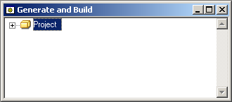

    The Generate and Build window appears. The Message Log pops up when you open the window. You can ignore its messages for now, and minimize it.
  2. If the Generate and Build window shows library objects, turn them off with the Show/Hide Library Objects toolbar button.
    The Generate and Build window now shows only the Project entity:
    PLEX--Generating and Building the Project Entity (9)
    PLEX--Generating and Building the Project Entity (2)
  3. Select the Project entity.

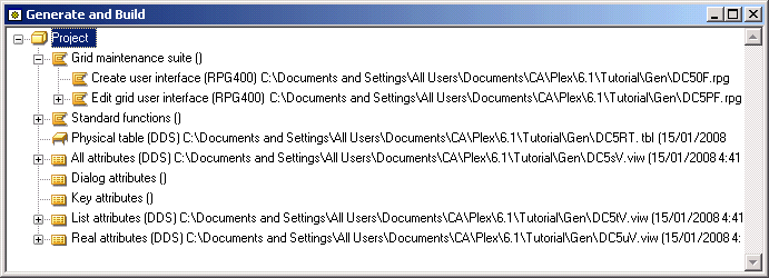

  4. Click the Generate and Build toolbar button. When you click this button, the Project entity expands, showing all of its scoped objects that can be generated. Those that will be generated are highlighted.
  5. A Confirm Generate dialog appears, indicating the number of objects that are generated. Not all of the scoped objects are selected. Click Yes.
  6. CA Plex generates those objects, and then summarizes the generation process. Click OK on the summary dialog when the generation completes (until the generation is complete, the button says Cancel).

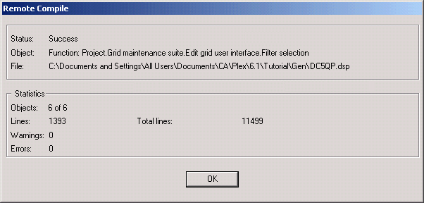

    CA Plex then sends the generated code to the System i you specified previously (For more information, see Specifying Build System Settings). The window shows the progress of transferring the source code on the Remote Compile dialog.
    PLEX--Generating and Building the Project Entity (4)
  8. After the code is transferred to the System i server, the server compiles it. Click OK on the Remote Compile dialog.

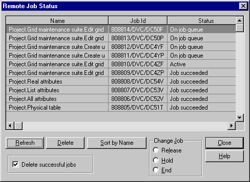

  9. Click the AS/400 Build Status toolbar button to display the status of your build.
    The Remote Job Status dialog appears.
    PLEX--Generating and Building the Project Entity (6)
  10. Click Refresh until all of the jobs indicate that they successfully compiled.
  11. When the build is done, close the Remote Job Status dialog.

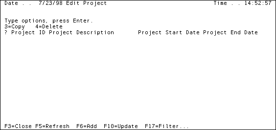

  16. Start a 5250 session.
  17. Enter call AA4ZF '', where AA4ZF is the implementation name you noted in Step 15.
    Your generated application starts, and should look like this:
