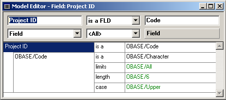

  3. To see more about what an object inherits from its ancestor objects, click the Two Levels toolbar button. The Model Editor changes to show another level of detail.
    PLEX--Defining Field Properties (6)
    Now, you can see that Project ID has inherited a data type of character and a length of six through the inheritance triple OBASE/Code is a OBASE/Character.
