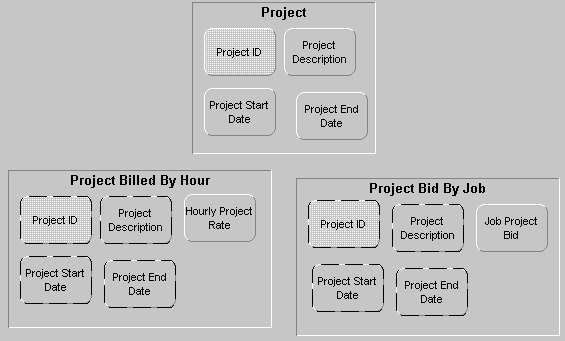

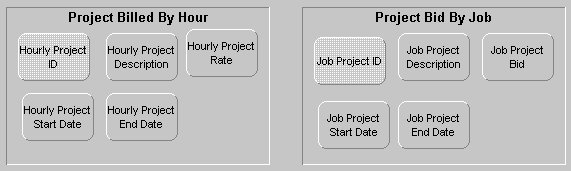

For example, you could create the following two entities, if you needed to create two types of Project entities in a project management application. One would represent projects that were billed by the hour; the other would represent projects that were bid by job.
PLEX--Inheritance (3)
Creating two types of Project entries would require a lot of duplicated effort. The identifier, description, and start and end dates are the same for both entities. Why should you create all of the functionality for these identical fields twice?
Using inheritance enables you to create a single Project entity with all of the common structure and functionality, and create two specialized entities that inherit from that one. Then, you can customize each type of project from there.
The following graphic shows the entities Project Billed By Hour and Project Bid By Job as they would appear after they have inherited from Project.
Note: The inherited attributes have dashed borders.
