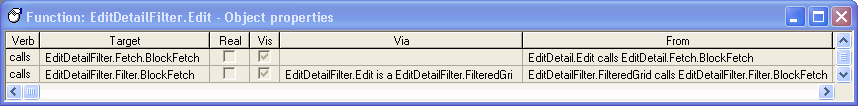

When you look at the calls for the EditDetailFilter.Edit you will see calls to two different BlockFetch functions:
Note that both calls are visible (the Vis column is checked). You can see this same behavior in r5.0 and r5.1. So which BlockFetch is actually called in the action diagram? This determination is made at action diagram load time. The result is sensitive to changes in the inheritance engine in recent CA Plex releases. The intention is that the Filter.BlockFetch should be called. To get this result at r5.5, CA has entered an additional replacement triple on the FOUNDATION pattern library:
FOUNDATI/Filter.FilteredGrid replaces FNC UIBASIC/UIBasic.Grid.BlockFetch
….by FNC FOUNDATI/Filter.Filter.BlockFetch
Previously, the BlockFetch function was not explicitly replaced. Instead the replacement was made only on the scoping view:
FOUNDATI/Filter.FilteredGrid replaces VW UIBASIC/UIBasic.Grid
…by VW FOUNDATI/Filter.Filter
With the revised algorithm used in CA Plex r5.5, this was not sufficient to force the required function replacement to occur. By adding an additional, explicit replacement on the BlockFetch itself, CA has been able to retain the required behavior in r5.5. Similar actions may be necessary in your own functions that exhibit this behavior.

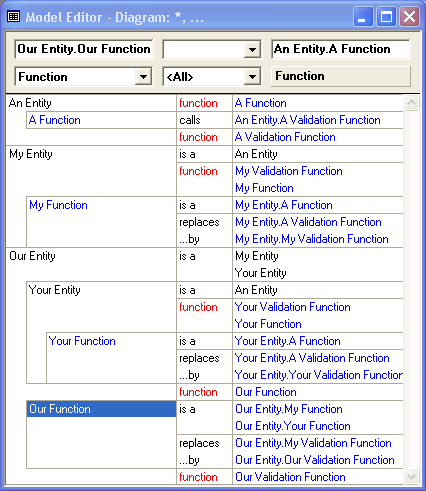

Consider the following set of triples:
This type of scenario is known as diamond inheritance due to the shape of the resulting inheritance hierarchy as shown by the following diagram.
The inheritance hierarchy starts at An Entity, diverges, and then the two branches are brought back together at Our Entity. This situation is quite complex but the examples in real customer models are often even more complex with further branches and layers of inheritance involved.

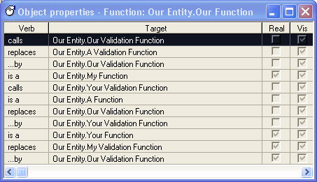

If you view the Object Properties for the function Our Entity.Our Function then you can see the two calls triples, both visible. There are two important points to note:
The only way to determine which function is actually called is to examine the action diagram code. This example again shows the changes in the inheritance engine over recent releases: At r5.0, Our Entity.Your Validation Function is actually called, but in all other releases including r5.5 it is Our Entity.Our Validation.
