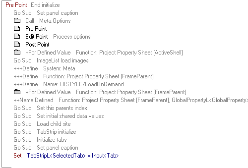

  7. Navigate to the Pre Point before the End Initialize Edit Point.
    There is already code in the Pre Point. The statement you add goes at the end, after what is already there.
  8. Add the following statement:
    Set TabStripL<SelectedTab> = Input<Tab>
    This sets the displayed tab to the one indicated in the input variable. The action diagram should look like this:
