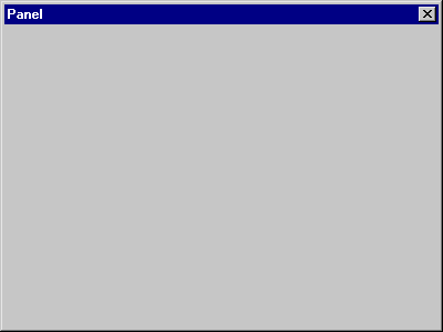

- Open Project Manager.Panel. Notice that, unlike the other panels you have worked with, this one does not come with any regions, buttons, or grids.
- Right‑click the top left corner of the panel and choose Create Push Button.
