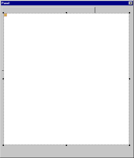

  3. Change the size of ChildSiteP so that it is 515 pixels wide (the width of the panel scoped to Employee.Edit), by 540 pixels tall (the height of the panel scoped to Project.Maintain Projects).
    The child site now extends past the right and bottom edges of the dialog.

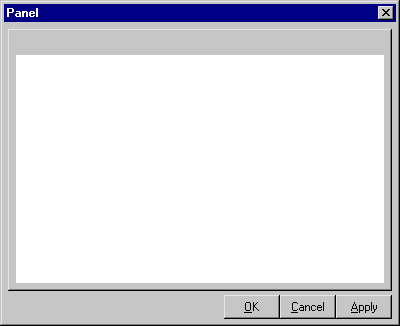

  4. In the Design Window, drag the right edge of the dialog so that it is a little wider than the child site. Then drag the bottom edge so that it extends enough below the bottom edge of the child site to display the OK, Cancel, and Apply buttons.
    The buttons are currently hidden behind the child site. The panel should look like this:
