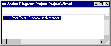

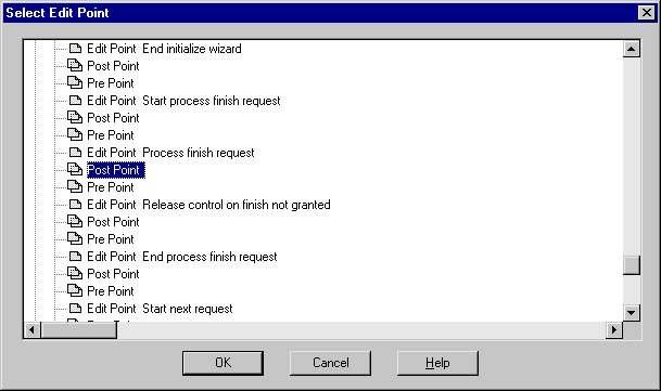

    The Action Diagrammer appears, with the Select Edit Point dialog over the Action Diagram window:
    Adding Commit and Rollback Processing (2)
  4. Select the Post Point that follows the Process Finish Request Edit Point, and click OK.
    The Process Finish Request Edit Point corresponds with the end user clicking the Finish button.
    The Action Diagrammer appears with the Post Point highlighted:
    Adding Commit and Rollback Processing (3)

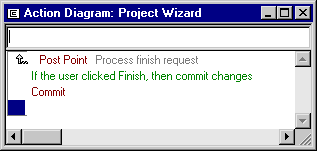

  5. In the input line of the window, enter Commit and press Enter.
    The statement is added to the body of the window:
    Adding Commit and Rollback Processing (4)
    In Step 2 you added the triple Project Wizard commit Parent. This indicated that you want to do commit/rollback processing. Adding the Commit statement indicates when you want the transaction committed.
