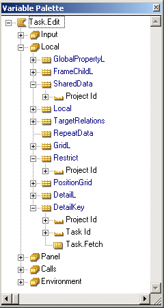

  3. Open the Variable Palette.
    Adding Project ID to the SharedData and Restrict Variables (5)
  4. Expand the Local variable group and then expand the DetailKey variable. Note that the Project ID field is available in this variable.
  5. Drag and drop the Project ID field from DetailKey to the Restrict variable. Then drag and drop it again to the SharedData:
    PLEX--Adding Project ID to the SharedData and Restrict Variables (4)
    You have now added the Project ID field to the SharedData and Restrict variables. This adds the following triples to the model:
    Task.Edit local Project ID
              ...for STORAGE/Restrict
              ...for UIBASIC/SharedData
