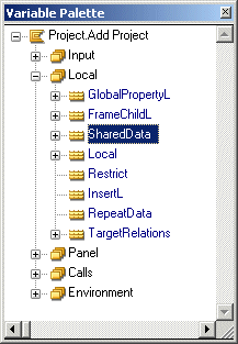

  3. In the Variable Palette, expand the Local variable group, and then select the SharedData variable:
    Adding a Field to a Variable (1)
    Adding a Field to a Variable (2)

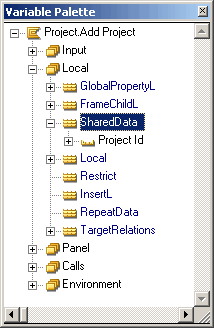

  6. Expand the SharedData variable:
    Adding a Field to a Variable (3)
    Refresh and notice that the variable now contains the Project ID field. This adds the following triples to the model:
