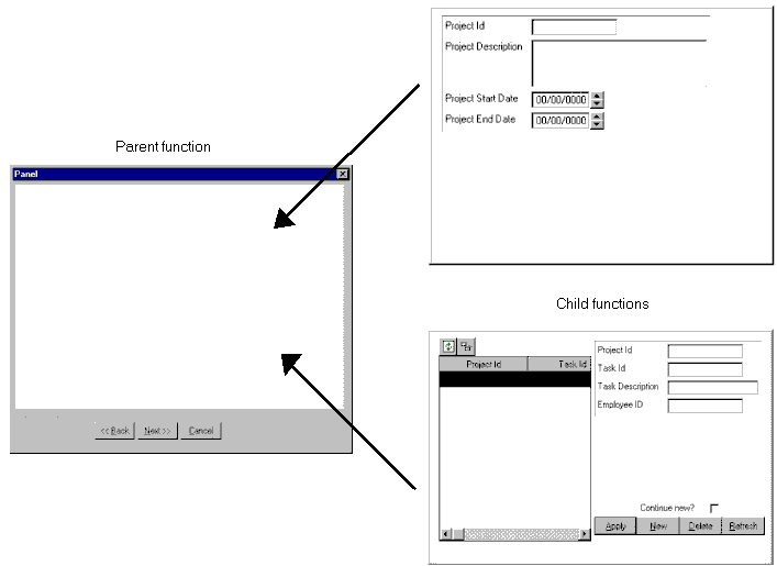

You create the wizard using a parent function that contains a child site, and two child functions that display panels inside the child site.
Defining the Wizard

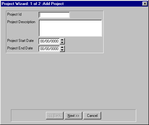

After you define the wizard functions, the user interface looks like this:
Defining the Wizard (2) Defining the Wizard (3)

    When you inherit from FrameChild, the panel scoped to your function becomes a child panel, which you can display in a child site on the parent panel of the wizard.

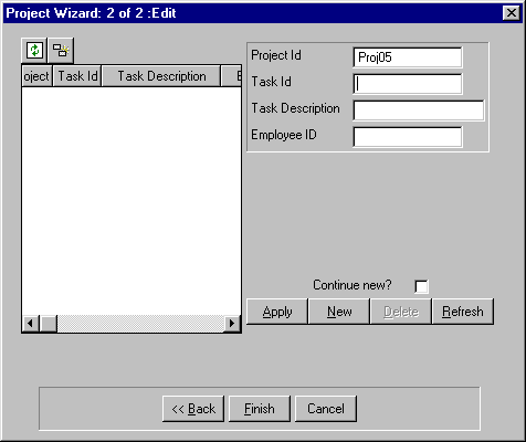

    Task.Edit is a FNC UISTYLE/FrameChild
    Note: To get the Task.Edit function into the source object box, drag it from the Object Browser.
    You created the Task.Edit function in the previous chapter, "Modeling Entity Relationships." Adding the is a triple modifies the function so that it can run as part of wizard.
