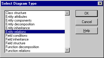

    The Diagrammer opens, with the Select Diagram Type dialog over it:
    Creating a Diagram (3)
  4. Select Entity Relations and click OK.

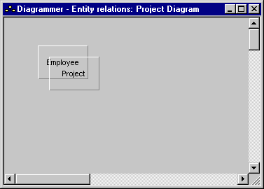

  7. Drag the Project and Employee entities from the Object Browser to the Diagrammer window.
    The Diagrammer window should look something like this:
    Creating a Diagram (5)
  8. Drag the Employee node down and to the right, so that it does not overlap the Project node.

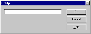

    The New Node dialog appears:
    Creating a Diagram (6)
    Note that the title bar on the dialog says Entity. The title bar shows you the type of node you are defining.
  11. Enter Task, and click OK.

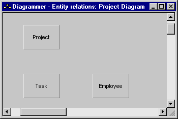

  12. Position the nodes (by dragging) so that the diagram looks something like this:
    Creating a Diagram (7)
