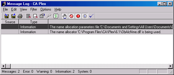

Three warnings appear in the Message Log during the generation and build processes. This is expected and not a problem. If you have additional warnings or error messages this may indicate a problem. The most likely cause is that you have not entered all the necessary triples into the model—go back and check against the instructions.
Errors are also likely if CA Plex did not install properly.
- One warning message (BLD9083) indicates that the Project Description field has a length greater than 255. This is not a problem for the database we are using.
- Two warning messages (BLD9081) indicate that no source for various views was submitted to the ODBC data source. This is expected because we set up CA Plex not to implement views in the Jet database being used for this tutorial.
