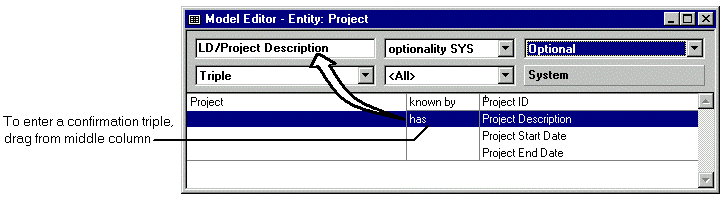

  3. Click in the center of the triple Project has Project Description to select it.
  4. Drag it to the source object (top left) box in the Model Editor:
    More About Optionality (3)
  5. Select optionality SYS from the verb (top middle) list, and Optional from the target object (top right) list.
  6. Press Enter.
    You have entered the continuation triple:
    ...optionality triples Optional
    Note: If you do not see this view, click the One Level toolbar button to set the Model Editor to show a single level of information.

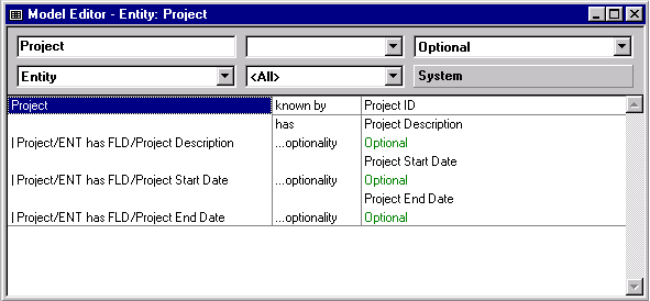

  7. In the same manner, make the Project Start Date and Project End Date fields optional.
  8. Refresh the Model Editor:
    More About Optionality (4)
