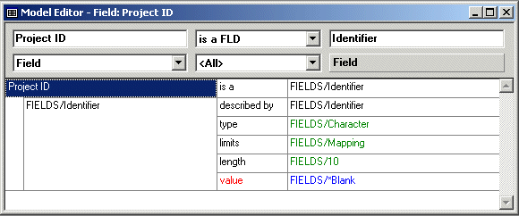

    Values are another type of CA Plex object. You can see that Project ID now has the value *Blank, but you cannot tell much else about what it inherited from FIELDS/Identifier.
  7. Drag the Project ID field from the Object Browser to the body of the Model Editor. The body is the bottom part of the editor, where the full triples are displayed.
    When you drag one or more objects to the body of the Model Editor, the display changes to show you only the triples that define those objects. This is called focusing the Model Editor. When you drag the Project ID field to the Model Editor, it focuses on this field, showing the triple Project ID is a FIELDS/Identifier. This still does not tell you much.
  8. To see more about what an object inherits from its ancestor objects, click the Two Levels toolbar button.
    PLEX--More About Field Inheritance (6)
    The Model Editor shows another level of detail.
    PLEX--More About Field Inheritance (5)
    Now you can see that Project ID has inherited a data type of character and length of 10, along with the value *Blank (which you saw in the Object Browser in Step 6).

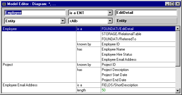

  10. Reset the Model Editor display by clicking the Clear Focus button. This displays all of the triples in the model, again:
    PLEX--More About Field Inheritance (9)
    PLEX--More About Field Inheritance (8)
    More About Field Inheritance (14)
    If your Model Editor displays a lot more triples than shown in the previous graphic, you have your model set to display library objects. If this is the case, click the Show/Hide Library Objects toolbar button.

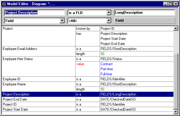

  11. Drag the Project Description field from the body of the Model Editor to the source object box. This field is in the third column of the Project has Project Description triple.
  12. Enter LongDescription in the target object box, and press Enter.
    Notice that the Model Editor displays the triple as:
    Project Description is a FIELDS/LongDescription
    This indicates that you correctly spelled the name of the pattern library field.
    Note: If you create a new object for a model, and it happens to share the name of a library object, you must rename your object or delete it (if you did not intend to create it).
  13. Repeat Steps 2-4 or Steps 11-12 to create the following triples:
    Project Start Date is a DATE/CheckedDateISO
    Project End Date is a DATE/CheckedDateISO
  14. Click the Refresh toolbar button on the main toolbar (not on the Object Browser). Your Model Editor should look like this:
    PLEX--More About Field Inheritance (16)
    Inheriting from DATE/CheckedDateISO gives the fields functionality to ensure that end users enter valid dates.
