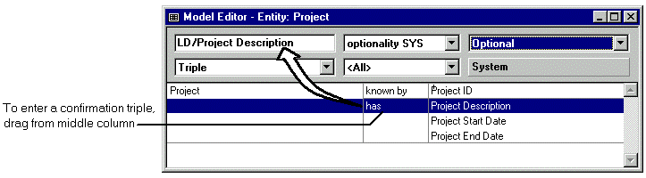

To use continuation triples to make fields optional
This focuses the Model Editor on the Project entity, showing only the triples that define that entity.
You have entered the continuation triple:
Project has Project Description
...optionality triples Optional
Note: If you do not see this view, click the One Level toolbar button to set the Model Editor to show a single level of information.

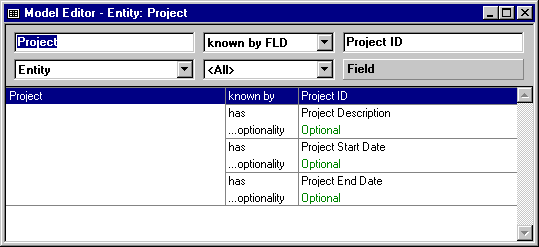

The Model Editor will look like this:
