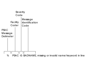

This appendix describes the format of the online error messages. It explains how to view the list of messages and get help with errors.
The figure below shows the parts of a sample message.
