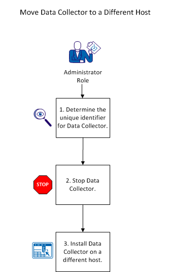

The following diagram shows how to move Data Collector to a different host:
Steps needed to move Data Collector to a different host:
To move Data Collector to another system, follow this process:
  1. Determine the unique identifier for Data Collector.
  2. Stop Data Collector.
  3. (for CA Mediation Manager integration only) Migrate device packs.
  4. Install Data Collector on a different host.
