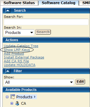

  1. Click the Software Catalog tab, and click the Show LMP Keys link in the Actions section on the left side.
    The screen capture shows the location of the Show LMP Keys link.
    A list of LMP keys for the indicated site ID appears.
