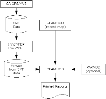

The following diagram shows the flow of the data that CA OPS/MVS collects:
Here is a description of some of the important items shown in the previous diagram:
Your copy of CA OPS/MVS.
The SMF data sets or System Logger logstream of the operating system, which are the possible destination for the SMF records that CA OPS/MVS collects. The destination is dependent on your system settings.
If you choose to send SMF records to the data set of the operating system, IFASMFDP is the IBM utility used to extract the exact data you want. For a sample of the JCL, see OPS.OPS.CCLXCNTL(OPAMESMF).
If you choose to send SMF records to the MVS System Logger, IFASMFDL is the IBM utility used to extract the exact data you want. For a sample of the JCL, see OPS.CCLXCNTL (OPAMESML).
The program that summarizes the data and produces an Automation Statistics Report. It will accept the data that IFASMFDP extracted from the SMF data set of the operating system or the data that IFASMFDL extracted from the logstream.
The record map for SMF records. This is provided in OPS.CCLXCNTL(OPAME000).
A JCL subparameter that indicates the ddname from which OPAME010 reads additional subparameters. See OPS.CCLXCNTL(OPAMERPT).
