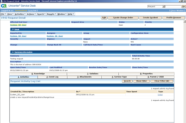

The following OPS/REXX code produces a detail screen of the create request. All requests are created as priority two.
address SERVDESK "REQUEST(CREATE) SUMMARY('Testing request')",
"DESCRIPTION('This is the test of address SERVDESK') WAIT(30) DEBUG(YES)"
if rc = 0 then say "Request was created: #"||SERVDESK.NUMBER
Produces the following detail screen:

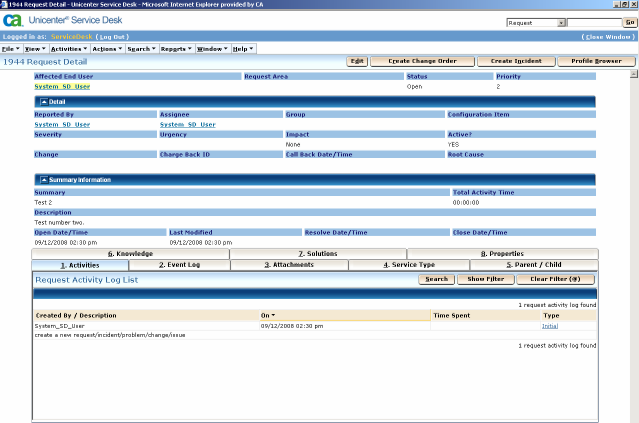

address SERVDESK "REQUEST(CREATE) SUMMARY('Test 2')
DESCRIPTION('Test number two.')"
