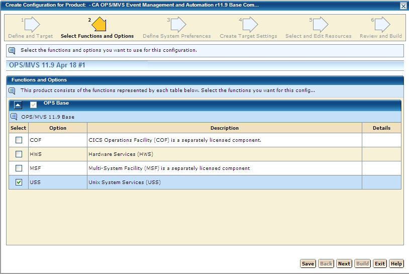

CA OPS/MVS Configuration Options Using CA MSM
You can configure the CA OPS/MVS Base operations and the following optional components using CA MSM.
COF
CICS Operations Facility; a separate license code is required.
HWS
Hardware Services
MSF
Multi-System Facility; a separate license code is required.
USS
Unix System Services; a separate license code is required.
To configure the Base operations only:
Do not select any options.
To configure the Base operations and any options:
Select the options you wish to configure.
