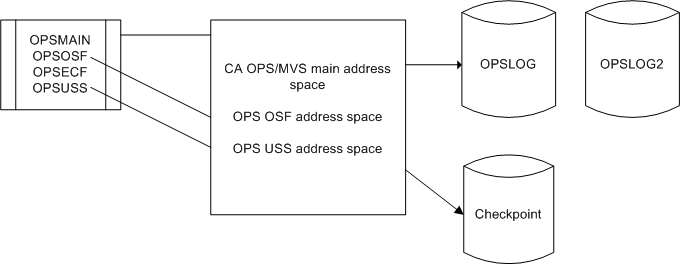

This is an example of a simple CA OPS/MVS environment that can be configured with CA MSM. This environment has a single copy of CA OPS/MVS running in one LPAR and two defined OPSLOGs. CA MSM does not presently contain support to configure CA OPS/MVS parameters files containing multiple system capability.
Note: This environment would be useful for testing the initial implementation of CA OPS/MVS in a situation where the user has little or no experience implementing and configuring CA OPS/MVS.
Note: Configuration with CA MSM will automatically execute some of the steps otherwise documented as manual steps elsewhere in this manual.
