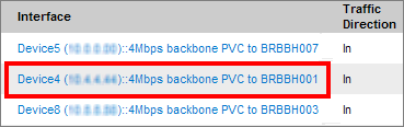

When you click an interface link on the Interface page, you drill down to an interface report. To view a report for a different interface, click the [change] link at the top of the page, then select another interface from the Interface Index. The report is updated to show data for the selected interface.
Use the [change] icon to switch the reported interface.
