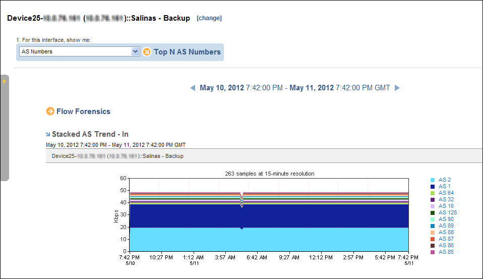

- Select AS Numbers as the report type at the top.
- Make sure the Top N AS Numbers link appears next to the report type setting.
The report page is updated.

- Stacked Trend Chart (default setting) of Rate, Volume, or Utilization data
