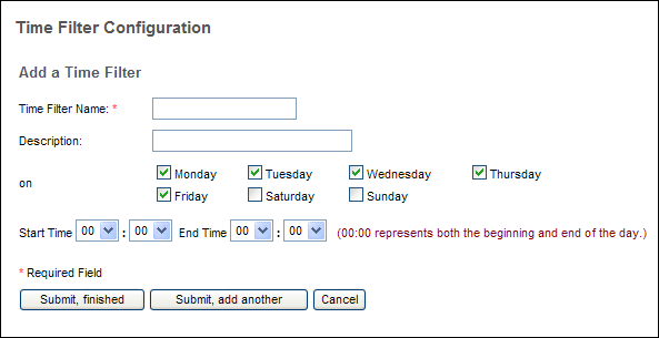

The Time Filter Configuration page displays options for adding a time filter.
- Enter values for the following options:
- Time Filter Name: Define the time filter identifier, which appears in the following lists:
- Time Filter Configuration page list (for administrators)
- Time Filter options that are available on the Specify Schedule page of the Custom Report wizard
- Time Filter options that are available when a user or administrator clicks the time period setting in a drilldown interface report of any of the following types: Overview, Protocols, ToS, Hosts, Conversations, Flows, Utilization, and AS Numbers
- Description: (Optional) Add information to identify the time filter, which appears in the list of time filters on the Time Filter Configuration page.
- on: Accept the default settings (Monday through Friday) or select other days for collecting report data.
- Start Time and End Time: Accept the default settings for the start and end of the daily time span or select custom settings, using the 24-hour clock system. The default setting of 00:00 and 00:00 includes data for all 24 hours of the day.
For example, to restrict the reporting period to business hours, select 08:00 as the start time and 17:00 as the end time. To set up a filter for backups that run from 11 P.M. Tuesday to 3:00 A.M. Wednesday, select Tuesday, then select 23:00 and 03:00.
- Save the time filter by clicking one of the following buttons:
- Submit, finished: Save the time filter and return to the time filter list.
- Submit, add another: Save the time filter and keep the Add options open so you can configure another time filter.
Note: To delete a time filter, select it from the list of available time filters, click Delete, then confirm the deletion when prompted. To edit a time filter, select it from the list of available filters, change any of the options that are displayed, then click Submit.
