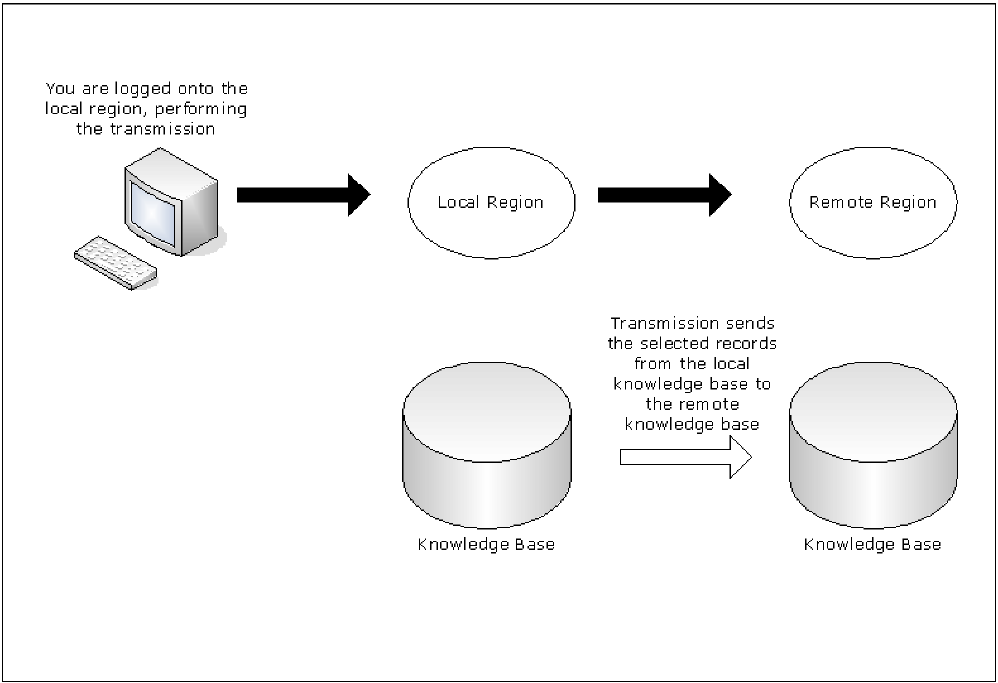

You can transmit (that is, copy) knowledge base records from the local region to a remote region that is not linked to it.
You cannot transmit a system image to a region in which the image is currently loaded.
By specifying the appropriate transmission mode on the Remote System Identification panel, you can specify how to update the records in the remote region.
The following transmission modes are available:
This diagram shows the transmit operation:
