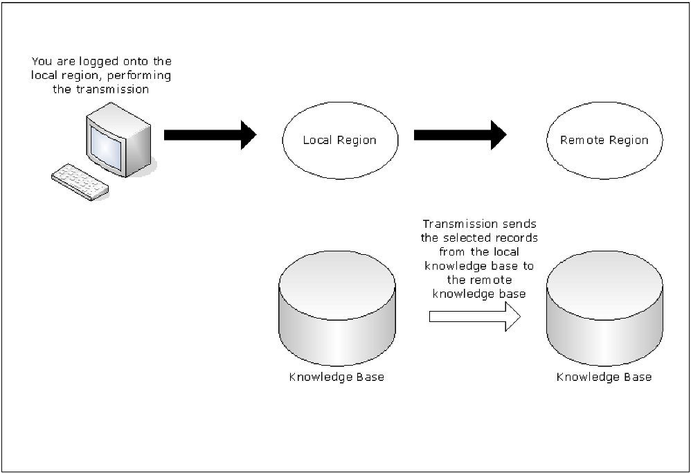

Transmit Records
The following illustration shows the transmit operation.
