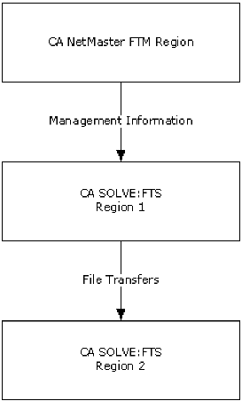

Handle Transmission Definitions That Specify DD Names
A CA NetMaster FTM region monitors the file transfers between CA SOLVE:FTS regions, which may or may not be managed by it. The following diagram shows an example where FTS Region 1 is managed and FTS Region 2 is not managed:
Example: Region 1 managed, Region 2 not managed
If a CA SOLVE:FTS transmission definition specifies a DD name that points to a data set in Region 2 and CA NetMaster FTM is not authorized in Region 2, CA NetMaster FTM will be unable to resolve the data set name and cannot monitor the data set.
To resolve this problem, perform one of the following:

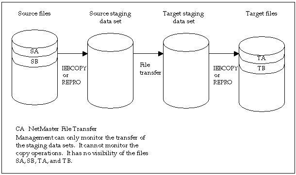

Considerations: Staging Data Sets
A CA SOLVE:FTS region can perform a file transfer by using staging data sets. Data from different sources are copied into the source data set for transfer. When the transfer is complete, data are copied out into the different target files. The following diagram shows the staging mode operation:
When staging mode operation is used, CA NetMaster FTM can only monitor the transfer of the staging data sets. It has no visibility of the files that were copied into that data set. For this type of file transfer, ensure that your file name criterion specifies the staging data sets and not the copied files.
