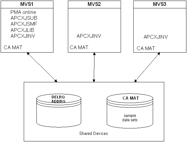

Multiple System Environment
If your work spans multiple systems, it is often difficult to determine on which computer a job is being processed. CA MAT measurement requests need to be entered in every computer system in order to guarantee that your job is actually measured. Performance Management Assistant can cope with this situation and thereby reduce your workload considerably.
If used in a parallel sysplex environment, Performance Management Assistant should be run as in a single system environment because CA MAT version 2 takes care of spreading the measurement requests. In this case, enter TARGSYS1(*) as an additional parameter on the panel for General Parameters.
PMA in a multiple system environment
