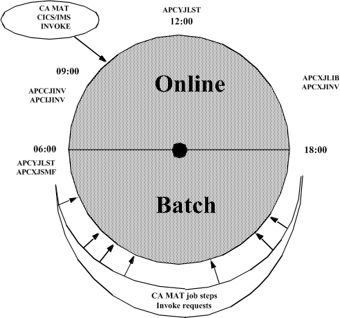

Scheduling Batch Jobs
This section provides a recommended time line for scheduling the batch jobs. The specific scheduling considerations of each job are detailed with the corresponding job section within this chapter. It is recommended that all Central Component batch jobs be executed daily.
It is strongly recommended that jobs APCYJLST, APCXJSMF, and APCXJLIB be executed serially and in the specified order. Failure to do so may produce unpredictable results.
The illustration following provides a guideline regarding how the execution of these jobs should be planned.
Job scheduling overview
